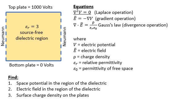

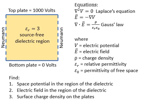

I'll start with the simple capacitor example in the figure below. The top and bottom of the unit square are capacitor plates.

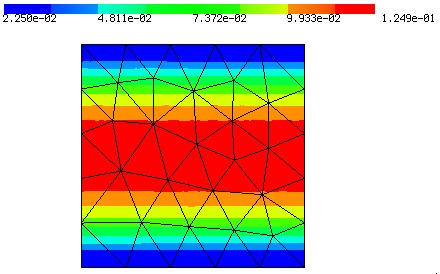

As a first attempt I tried to adapt the Poisson example (for those unfamiliar with these concepts, the Laplace equation is a special case of Poisson equation with no source (no space charge) in the dielectric region. The faulty output result follows.
Questions:
My goal with this thread is to get some basic 2D and 3D examples going in the area of electrostatics. Hopefully over time this can serve as supplementary documentation for folks like myself who are a bit overwhelmed by trial functions, test functions, bilinear forms, Galerkin methods etc.

3) Yes, for the Laplace equation it has to be zero. I guess you got the zero solution, when setting it to zero. The reason for this is that you have to homogenize your problem for non-homogeneous (non zero) Dirichlet data as described in the documentation , namely
