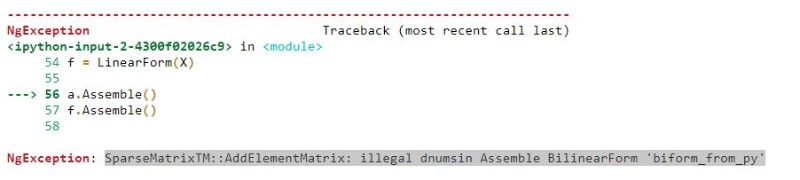

I used sh*dx(skeleton=True) as in the tutorial to compute the integral on inteface of s_h, but there is a traceback call.
I also attached my .ipynb file. Could you please show me fixed this error or how to compute that integral on only interfaces?

Replied by mneunteufel on topic Integral on only intefaces, not on boundary faces
Hi dong,
you need to set the dgjumps flag for a DG formulation as described here
Then your code should run through.
Michael
V = VectorH1(mesh,order=2, dirichlet ='left|right|top|bottom', dgjumps=True)
Q = H1(mesh,order=1)
X = FESpace([V,Q], dgjumps=True)
Michael
