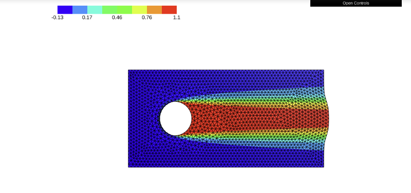

Another feature I would like to have is the ability to adjust bounding box size of the gui, like in matplotlib, we can do
The current default size might not be optimal. e.g. the example below on a slightly stretched domain, it has quit large empty white spaces:
Guosheng
