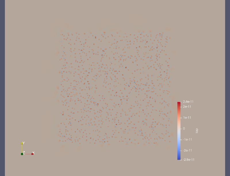

Edit: I just substituted the phase field with the constant function 1 and even then the laplacian is not approximated correctly (Image attached), so there must be some error in using NGSolve I suppose.

well, the picture you are showing is zero up to 1e-11. The u.Set(1) does element-wise L2-projection, and you get some roundoff errors. Interestingly, by interpolating using dual shapes, the Laplacian will be exactly 0. You get that via
u.Set(1, dual=True)
u.Set(1, dual=True)
