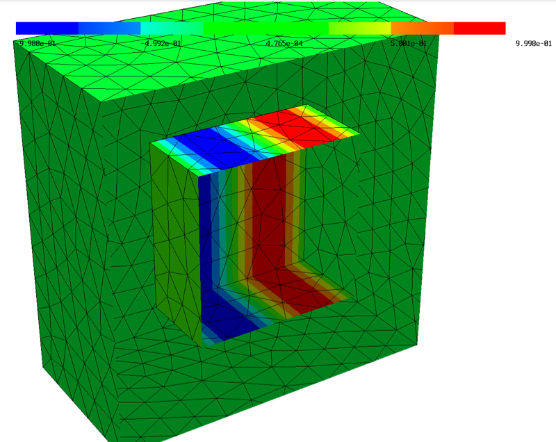

I have two questions. It would be very helpful if anyone can answer any of them. Thank you.
1. I have a mesh with two materials ("inner" and "outer" ) and I have an L2 GridFunction defined on the inner material. I'd like to define an L2 Facet GridFunction on the outer material and then set the values on the interface ("interior boundary") based on the L2 GridFunction.
I tried the following code but it doesn't work. The dofs of the L2 Facet GridFunction are still all zeros. I wonder what's the right way to do this.
2. Another question I have is how I can set order when I integrate with dx, ds. I tried the following but it gives me an error.
Thanks.
Oliver

4 years 11 months ago #3173
by joachim
Replied by joachim on topic L2 GridFunction and Integration order
Hi Oliver,
here you can use the BoundaryFromVolumeCF, an example is attached.
copied from help(BoundaryFromVolumeCF):
BoundaryFromVolumeCF(...) method of builtins.PyCapsule instance
BoundaryFromVolumeCF(vol_cf: ngsolve.fem.CoefficientFunction) -> ngsolve.fem.CoefficientFunction
Allows the evaluation of volumetric functions on the boundary.
When evaluated on a boundary element, this function searches for the associated
volume element, transforms the local coordinates, and evaluates the function in the
volume. A typical use case is to visualize L2-functions, or mechanical stresses at
the boundary.
It is different from the boundary Trace()-operator. The trace provides a function
which is defined by boundary degrees of freedom only. E.g. the trace of an H(div)
function is only the normal component, while the BoundaryFromVolumeCF gives the
whole function. Obviously, the Trace() function is cheaper to evaluate.
If called on an interface, it evaluates from one side (which one is not specified).
If the function is only defined on one side, this side will be taken. One can use
a domain-wise CF to define a function only locally:
uloc = CoefficientFunction( [None, None, u, None] )

The following user(s) said Thank You: oliverxia2020

4 years 11 months ago #3196
by oliverxia2020
Replied by oliverxia2020 on topic L2 GridFunction and Integration order
Hi Joachim,
Thank you for your reply. Everything works for me now.
Oliver
Oliver
