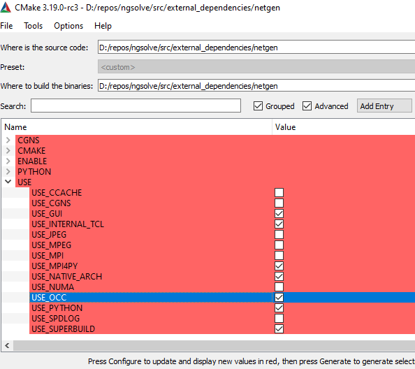

For occ, I'm using USE_OCC option in CMake to install occ with Netgen.

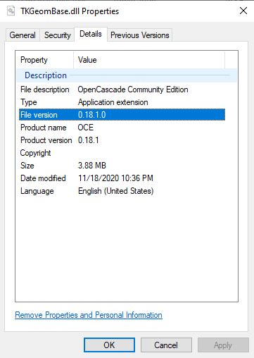

A picture for occ version is attached.

Hm. OCE 0.18.1 is based on OCCT 6.9, could you try using a newer version (7.5 is currently available) and try it again? I think this might be a bug in occ that is already fixed in newer versions. The installer is built with occ 7.4.

I tried with occ 7.5 and it worked, many thanks.
