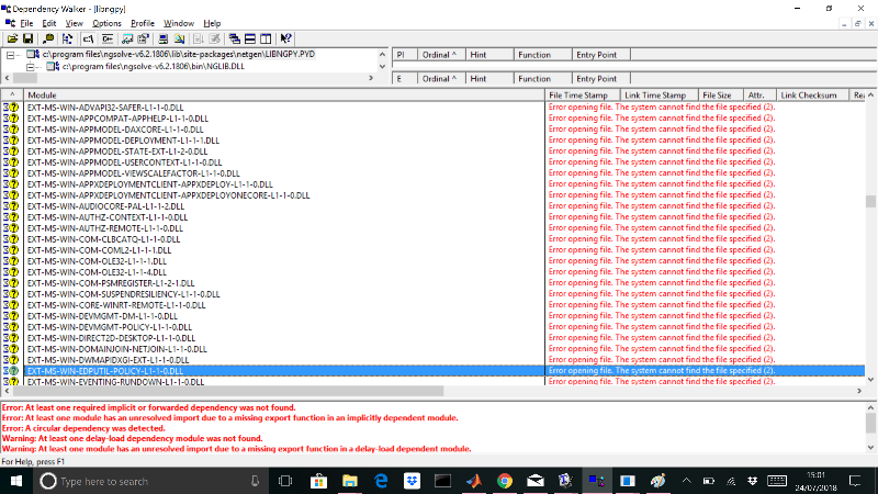

There are too many libraries missing to printscreen but I am attaching some examples:
API-MS-WIN-...
or
EXT-MS-...
The only ones not of this form are:
DEVICELOCKHELPERS.DLL
EMCLIENT.DLL
IESHIMS.DLL
and the message is the same.
There are also some warnings:
Is it worth saving this as a .dwi file and sending it to you?
Thanks for this,
Susana

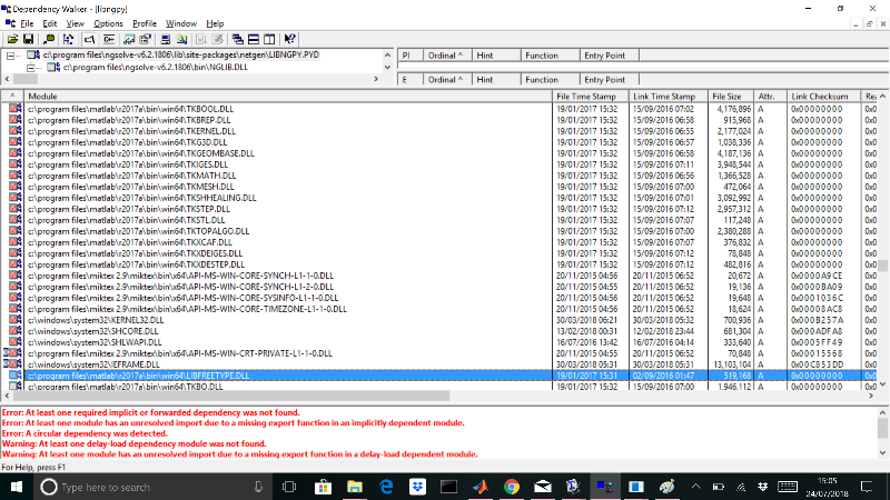

Indeed I see other possible issues on the last screenshot: Opencascade libraries are not loaded from the Netgen install dir but from a Matlab installation. Possibly that's the cause of your problems. You could try removing "C:\Program Files\matlab\r2017a\bin\win64" from PATH (either user- or system-wide) and see if that helps.
