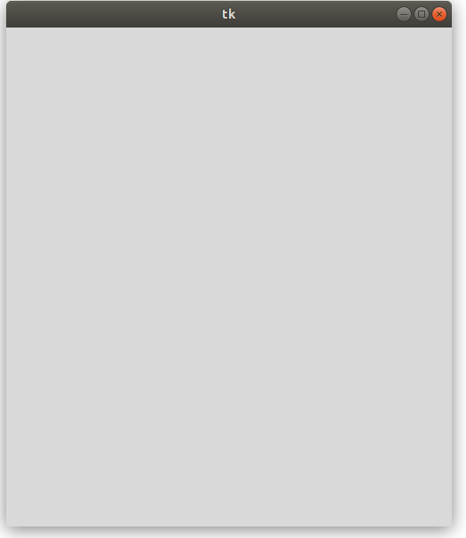

I used the following lines to install ngsolve via the Conda installer in my local cluster:
The installation was successful, everything is local in my folder ~/NGSolve
However, the gui is not working properly, it only pops up a window without any information. See attached photo.
Guosheng
Guosheng

Hello again, please discard the previous message, after run
I realized that it is pointing to an older build from source without GUI.
After a correct environment setup, everything seems working up to now. In particular, the umfpack and pardiso solver are all working nicely.
Thanks again for all your effort to make easier the installation!!!
