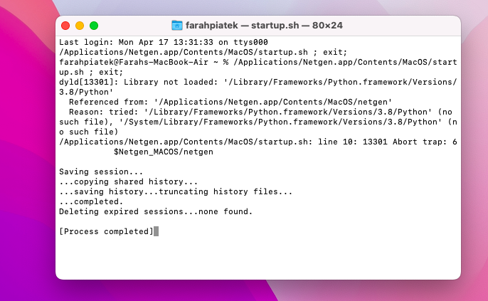

where can I find this PIP installer for MacOS Monterey version? I have this problem showing up when I launch Netgen. Here is what I get when I open Netgen below. what do I do to be able to open Netgen? I tried downloading Python and it didnt work. thanks /Applications/Netgen.app/Contents/MacOS/startup.sh ; exit; farahpiatek@Farahs-MacBook-Air ~ % /Applications/Netgen.app/Contents/MacOS/startup.sh ; exit;dyld[13301]: Library not loaded: '/Library/Frameworks/Python.framework/Versions/3.8/Python' Referenced from: '/Applications/Netgen.app/Contents/MacOS/netgen' Reason: tried: '/Library/Frameworks/Python.framework/Versions/3.8/Python' (no such file), '/System/Library/Frameworks/Python.framework/Versions/3.8/Python' (no such file)/Applications/Netgen.app/Contents/MacOS/startup.sh: line 10: 13301 Abort trap: 6 $Netgen_MACOS/netgen Saving session......copying shared history......saving history...truncating history files......completed.Deleting expired sessions...none found. [Process completed]

Replied by matthiash on topic PIP installers available!
Hi!
You were using the .dmg bundle, right? This depends on a specific Python Version (3.
. So you could install Python3.8 to solve the problem.
But I advise you to use the pip installer instead, remove the bundle and then run:
python3 -m pip install ngsolve

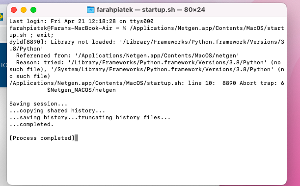

I entered this command in "terminal" window and this is the screen I got (I tried this twice just to doublecheck). see below:
But then when i open Netgen, this is the warnings I get. see images attached. Its the same message box. (all of this opens in "terminal" app immediately.
Let me know what else I can do

I am sorry for asking again. but when i removed the Netgen bundle and ran the command in "terminal" app on MacOS, it still show the popup screen as this: I am not sure what else to remove besides the Netgen application. I am sorry for being so clueless. thank you for any help:Defaulting to user installation because normal site-packages is not writeableRequirement already satisfied: ngsolve in ./Library/Python/3.9/lib/python/site-packages (6.2.2302)Requirement already satisfied: netgen-mesher==6.2.2302 in ./Library/Python/3.9/lib/python/site-packages (from ngsolve) (6.2.2302) [Process completed]
