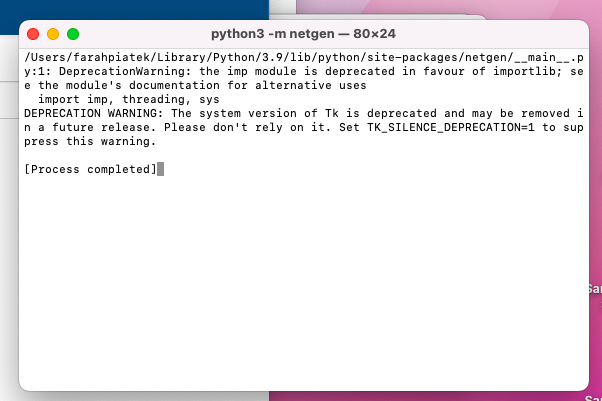

Try to run
python3 -m netgen
to start the version you installed with netgen (the warning you got with installation is no problem)

2 years 4 months ago #4776
by Farahq11
Replied by Farahq11 on topic PIP installers available!
I did this and got this popup screen below. the thing is I removed the Netgen bundle so I dont have it on my mac anymore. should I redownload the Netgen? see below for the popup screen/Users/farahpiatek/Library/Python/3.9/lib/python/site-packages/netgen/__main__.py:1: DeprecationWarning: the imp module is deprecated in favour of importlib; see the module's documentation for alternative uses import imp, threading, sysDEPRECATION WARNING: The system version of Tk is deprecated and may be removed in a future release. Please don't rely on it. Set TK_SILENCE_DEPRECATION=1 to suppress this warning. [Process completed]
